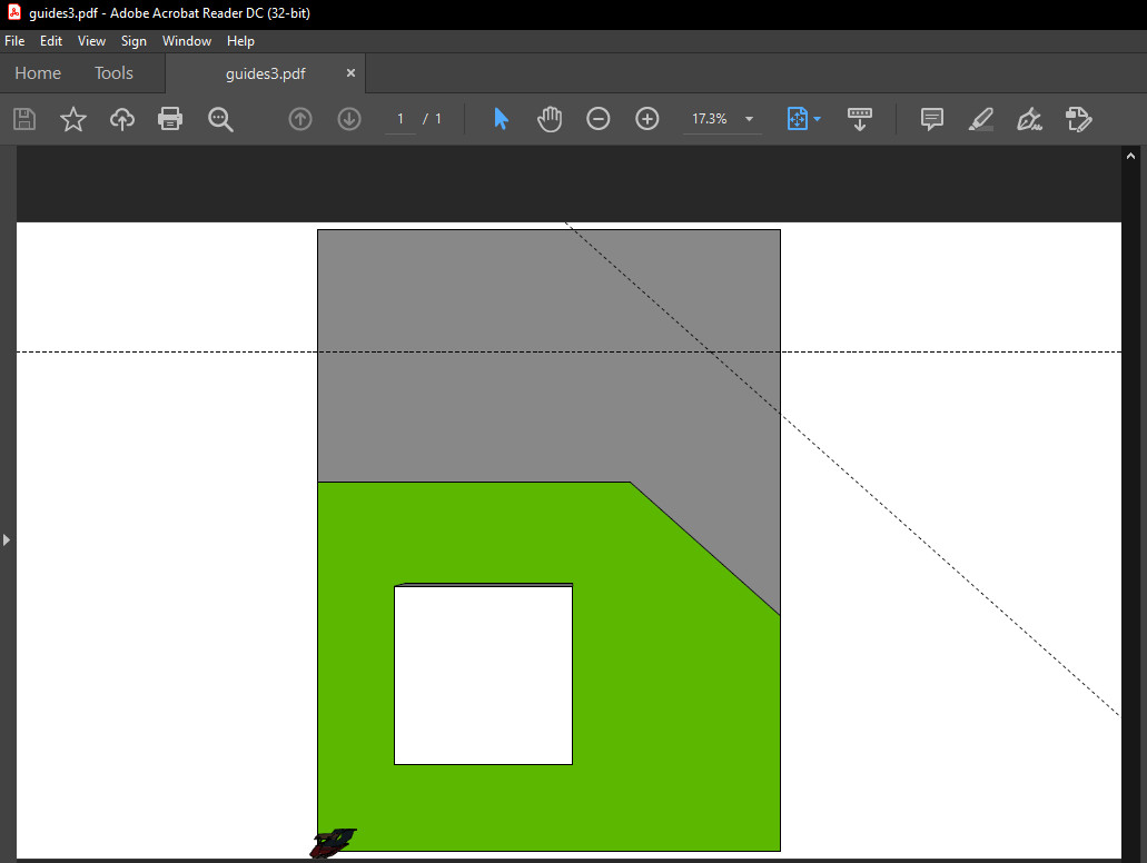

For export, you can replace them with some lines in a layer with the dotted line Dashes
Or you can print directly
Only vector lines will be shown in PDFs exported directly from SketchUp. Guides are raster so not shown. Yes, you could do this in LO but as Mihai suggests, you can replace the guidelines with edges that you group. Then you can give the group a tag which has a dashed style selected.

It means that instead of File > Export > PDF, you’ll go with File > Print > PDF.
This isn’t a workaround. Guides are not meant to be used the way you are trying to use them.
