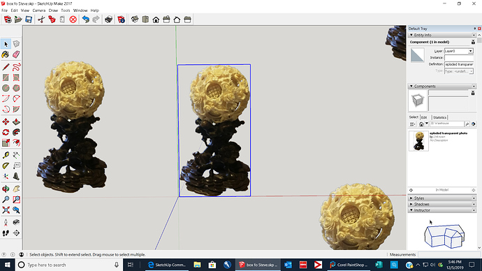

I’ve imported into the desktop application of SketchUp 2017 a .png image that I’ve carved from a jpg. in Corel Paintshop pro. Importing the file in png. kept the transparency I need, as I will be nestling the image into a fitted box. Saving the image as a component and then pulling up the face doesn’t make it solid. How do I give it depth? I’m using Windows 10.
Read other posts with similar questions and have tried downloading some of the extensions to try them out. They won’t open. Windows wants to know what application I want to open the file with…
