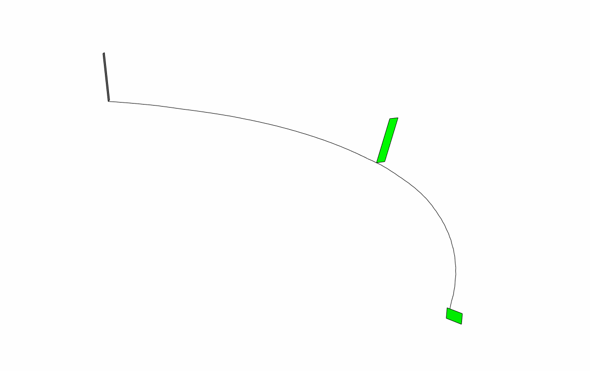

How do you make a wall tilt in 2 different directions?
well while I have your attention again (because you are always super helpful), are there other ways to create surfaces on non-coplanar faces than bending something or using the sandbox draw-from contours tool? I’m trying to find more extensions capable if it is possible.
You were talking about Curviloft in your first post. That’s a great tool, seems like maybe there is a pathway to this shape there?
1
Here I use the original setup shapes from your file to define the upper and lower arc, then curviloft to form faces and JPP to thicken.
