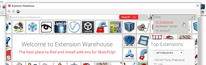

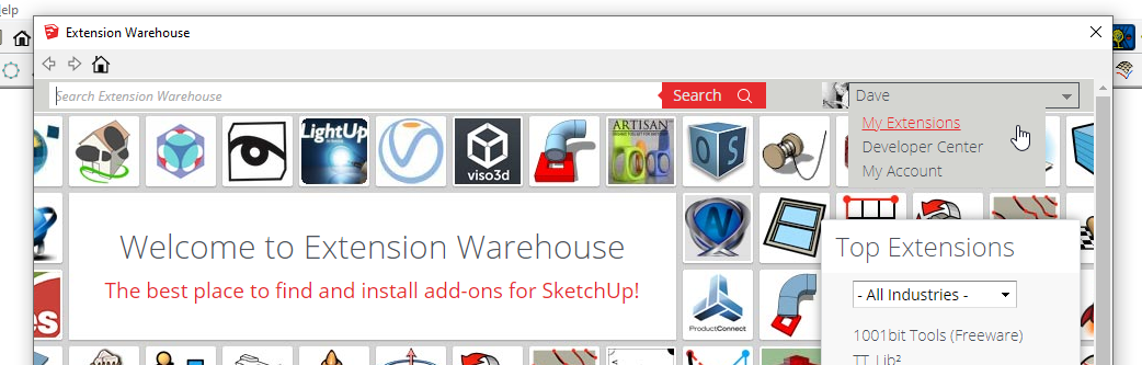

Extensions that you downloaded and installed by accessing the Extension Warehouse in SketchUp can be automatically installed on your other computer. Open the EW panel and hover over your name in the upper right corner. Choose My Extensions.

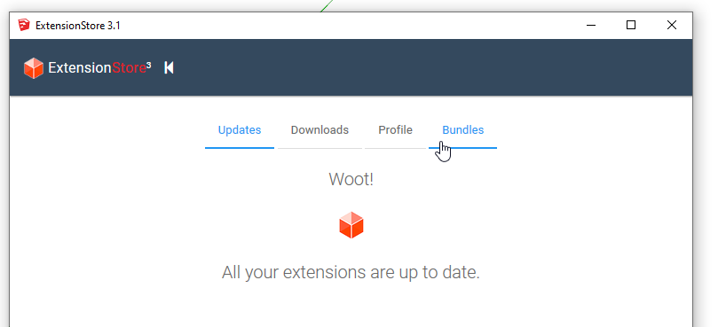

If you have extensions from Sketchucation AND you used the Sketchucation Extension Store tool to install them, you would have a bundle that can be installed automatically, too.
