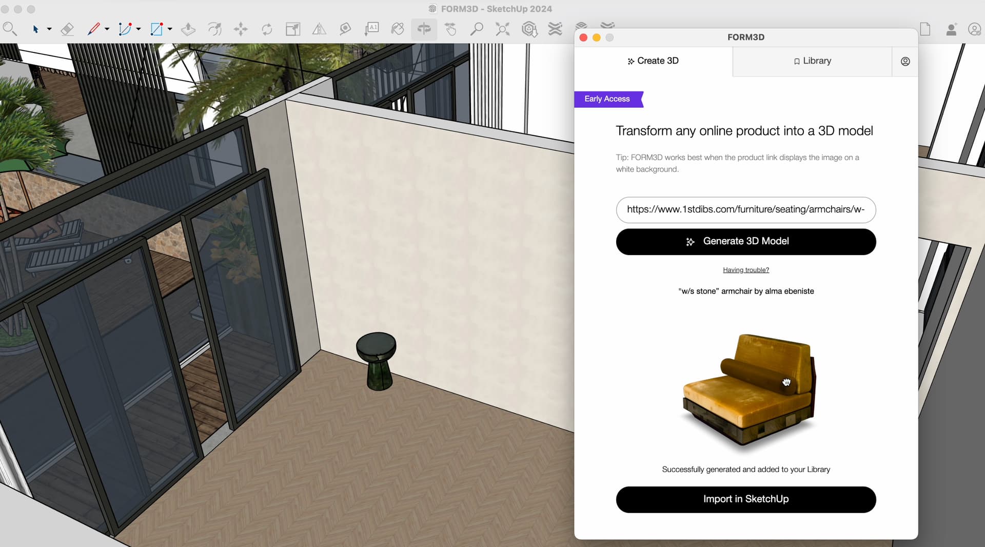

Sure thing, the basic idea is: paste a furniture product link → FORM3D extracts the product data and generates a SketchUp component you can drop straight into your model.
Here’s a quick example:
It’s not meant to be a fully detailed manufacturer CAD file, but it gives you a fast, workable model of real-world furniture without having to build everything from scratch.
Happy to share more examples if that would be useful!

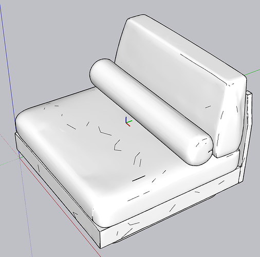

I’ve been working with the team to optimize the parameters and ran the same product again. I’d really appreciate your feedback on this updated .skp file, especially around the edge count, nesting, and overall usability.
FORM3D Updated Parameters.skp (7.3 MB)
Thanks again for the earlier notes, you have been super helpful in guiding improvements!

I agree with @Box and @AnnoNiem
Still too much geometry and nesting levels. And now it looks like the mice have been eating at it.
There’s no need for the internal faces, nor having the back and bottom subdivided like they are.
