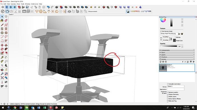

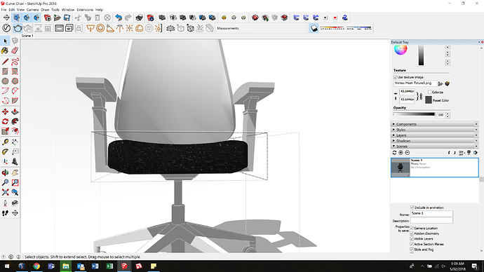

Can someone please help me with this seat? I have used cutting models to shape this seat and i have achieved the right curves for it, however as you will notice in the attached picture that it has a sharp corner. Is there any way i can remove this? I have tried using the cutting model method but it keeps telling me that the seat isn’t solid.
I will be making similar models of office chairs in the future and would like some tips on how to draw up seats like this. Is there an easier way to make a seat with curves in different directions?
Thanks in advance.
It’s not possible to tell just from images.
Can you upload the SKP file itself, so someone can have a look?
It’s possible that either the FollowMe tool or Fredo6’s Round Corner plugin could fix the sharp corner.
And Solid Inspector2 plugin could help you analyse why the seat isn’t solid - again, one can’t tell just from the image.
Sorry…Please see the skp file attached.

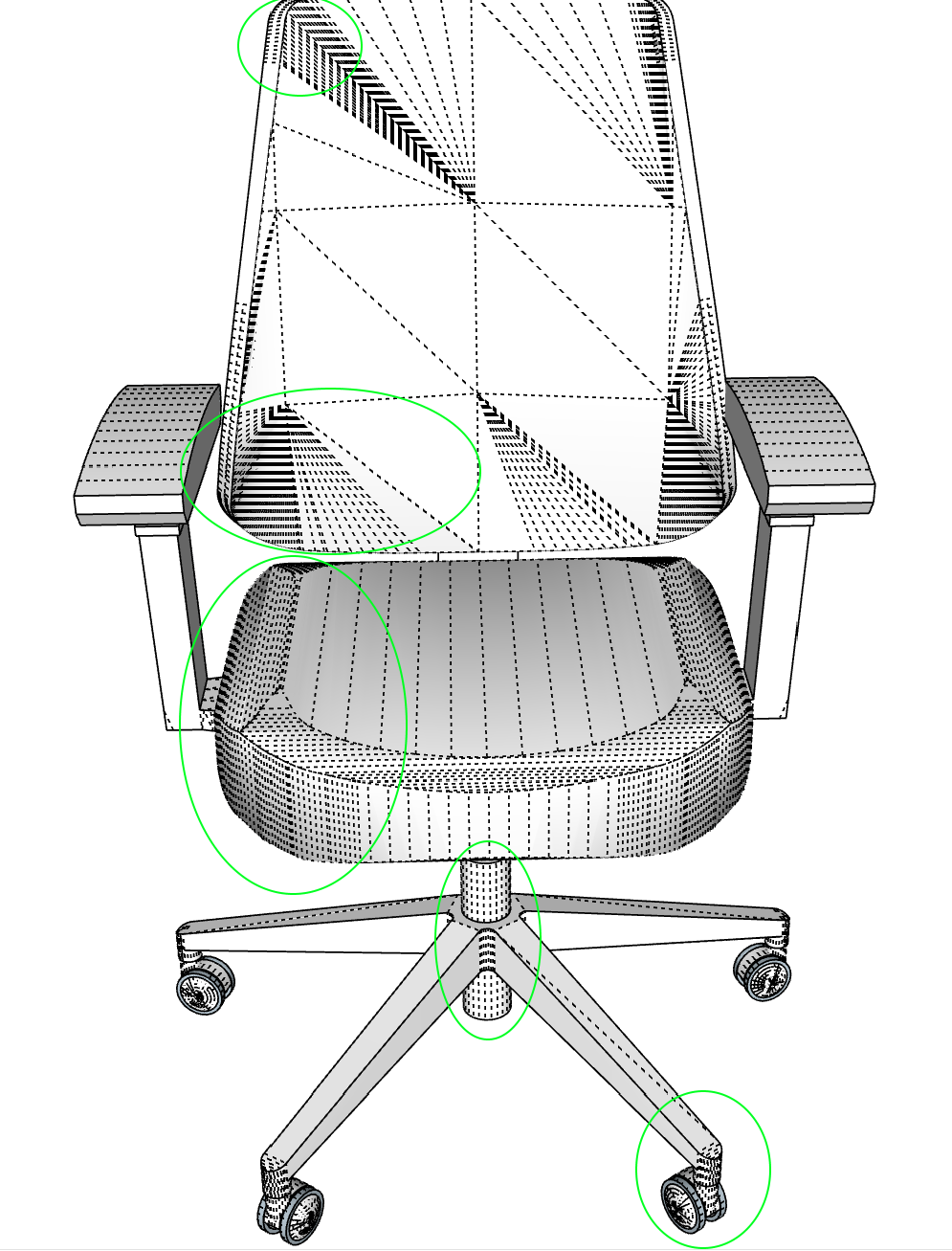

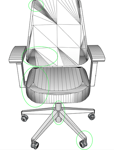

As rendered onscreen (Style) it’s impossible to see the geometry.
Render the model in a way that’s to your advantage.
• Turn shadows OFF
• Turn Monochrome ON
• Turn Hidden Geometry ON

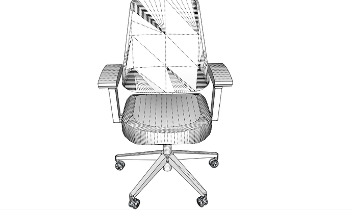

Way more geometry than necessary.
Overly complex geometry doesn’t make a model look better.
It does make the model more difficult to work with and weighs heavily on performance.

Then it is already overly complicated, especially the seat, back and wheels.
Yes, for file size but the both halves count fully when the model is open in SketchUp. Less overall polygons is the target.
