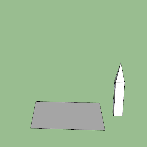

For many components, the default ‘bottom left’ position is fine.
For some, bottom centre works better, if you want to position them aligned centrally, and/or they are symmetrical left to right. .
I prefer origin at centre for circular components - they are usually easier to draw that way (often about the origin), and to register centrally with other circular components.
If you change your mind, use R-click ‘Change axes’.
Here’s a very basic example of how setting you axis, and therefore your insertion point, can be useful.
Axis
