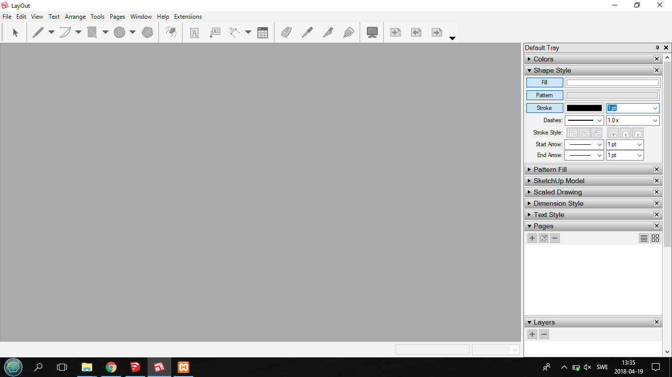

Hmm, nothing happend when I sent to layout.
That’s odd. Did you use the icon or the menu? Here it is in the menu:
34
If still not working, try uploading the SU file in your reply.
I’ve seen from other users issues with the send to LayOut function not working with the trial version in some cases, can’t remember if they got it working or not though.
@Kammerfors Try closing the LayOut application if you have it open before trying to send the SketchUp file.
Obviously the alternate is to insert the SketchUp model from within the LayOut application.
The other thing that springs to mind is whether SketchUp were installed correctly by right clicking the installer and selecting “run as administrator”.
