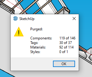

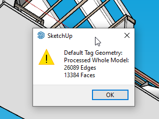

Finally! I got it to behave. There is a component in your model called fdg or something similar that is huge and seems to be corrupted. I remove that and also purged a lot of other stuff after fixing the camera (located out by Saturn) and incorrect tag usage.
That reduced the file size by more than 80%. See how you manage with this file now.
