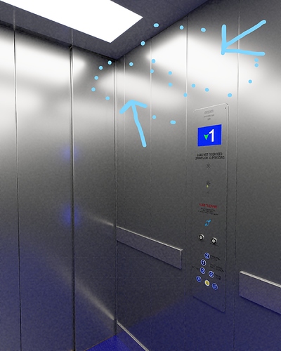

I’m rendering the inside of an elevator using Vray and need some help making the render resemble a real life image of the same elevator.
As you can see in the render attatched (low quality draft), The lighting on the metal reflecting the same as it does in real life (image attatched). In the real photo the light reflects in a cone shape but in my render its similar to a mirror relection. Any advice on how to achieve the “cone effect reflection” in my render would be appricaited.

Maybe the cone shape is due to a fine brushed finish?
I believe it could be that. Do you have any advice on how I could add that to brushed finished to my wall textures? (and have the cone shape visible)

I didn’t notice this was the V-ray section. I don’t know how to get that in V-ray. Maybe there is a brushed stainless steel texture you can download. Here is an example in Thea using a texture that’s already made. Not really the same as the photo but not a mirror reflection
Would this brushed mat help?
It’s the anisotropic properties of the metal finish.
You are unlikely to achieve the effect you desire with maps but you can set the anisotropic properties of the material in vray asset editor (amount, rotation angle etc
