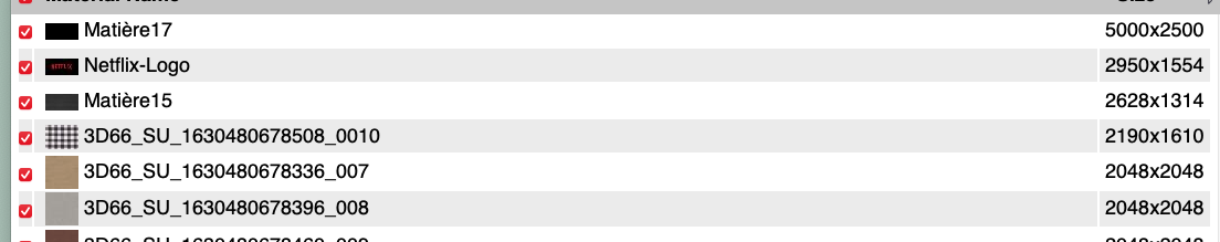

  • or you have a file with lots of materials with lots of stupidly big sizes. like a 4000x5000 20 mb image for a door handle. that kind of stuff.
your file has both, and yes, as Cappo sais, it’s because of all the warehouses things.

I’m using a pair of extensions, free, from the 3d warehouse :
material resizer and CG impact repost. the first allows me to select some materials and make them smaller (therefore lighter), the other tells me what components and groups are complex, and allows me to select them.
Capture d’écran 2023-10-12 à 12.06.47
and you see, no matter how many purges and how small I’ll make the materials (I’ve tried at 720px maximum), your file will remain big because you have 300+ materials, and hard to manipulate because you have 8,5 MILLION lines and 5,4 MILLION faces.
mostly beds, pillows and blankets though.
I noticed that some of the component were actually scaled down. you downloaded a big size component and scaled it down to put in your model. This is usually a good indication that you’ll get trouble later : if the component was modelled or imported at bigger scale, chances are it was detailed for this bigger scale.
here is your file post purge with materials limited to 720px. might be a bit low, you’re free to reopen the original file and resize to 1000 or 1200 px. it’s still 500+ mb because it’s still just a LOT of things with a LOT of materials and a LOT of geometry you don’t need.
