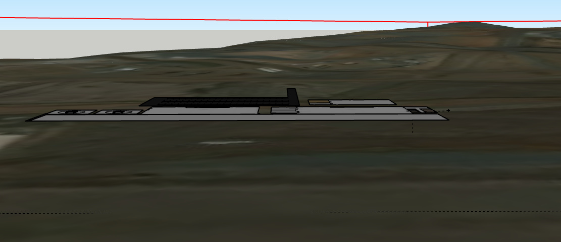

I’ve read about the stamping tool and watched a tutorial but when I follow the below procedure, number 5 is not working. Sketchup does not allow me to click on the terrain…
(The terrain is from an imported geo location)

As you can see, I’m trying to stamp my object to the terrain surface.
The red bounding box in your screenshot would indicate the terrain Group is locked.
Right context click on the Group > Unlock
@Geo your a legend.
It worked well.
