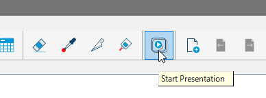

I notice in this video, there is a “Start Presentation” button on the top right of their page. They are using a Mac in the Video Tutorial Video. Where can I find “Start Presentation” on a PC?
Screenshot - 7_1_2024 , 5_43_41 PM
