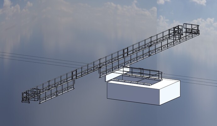

I am designing some handrail for a site. I was just mapping out some existing handrail down down steps and the end return it kept bug splatting. I kept trying it and it worked eventually.

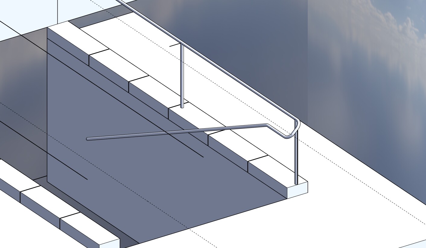

The end return seen here is what i was trying to get the radius on.
Maybe it’s that background image.
I didn’t mean an image in the sense of a large picture. I mean something that is being used as a texture is causing a problem. A copy of the SKP would be useful.
It does turn out that there is an existing bug report, SKOR-20113 in our system, about crashing when using the new graphics engine, and with the Radius Tool extension installed, a crash will happen. Work around for now is to set the graphics engine to the classic one, in Preferences, Graphics.
