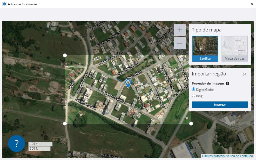

The following message is displayed when I use the “add location” function: " Do not close this window. Please wait patiently. Large area imports can take several minutes to complete.". But the region I want to import the Digital Globe image is very small, even so the image is not imported, after hours of waiting. I’m using Sketchup Pro 2022 Version 22.0.354 64-bit. My computer is Windows 10.
What could be going wrong?

The region I want to import is in Brazil, in the state of Santa Catarina. In the city of Palhoça, where I live.

The coordinates of the region are: 728246.067 East; 6942305.707 North. These coordinates are in the UTM 22 J projection. It is located in the city of Palhoça, in Brazil.
That went even more quickly for me than the previous one due to the smaller region. I wonder if you have an internet connection issue. Just to rule it out, try quitting SketchUp and shutting your computer down completely. Then restart it and try again.
