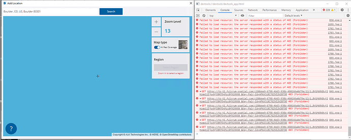

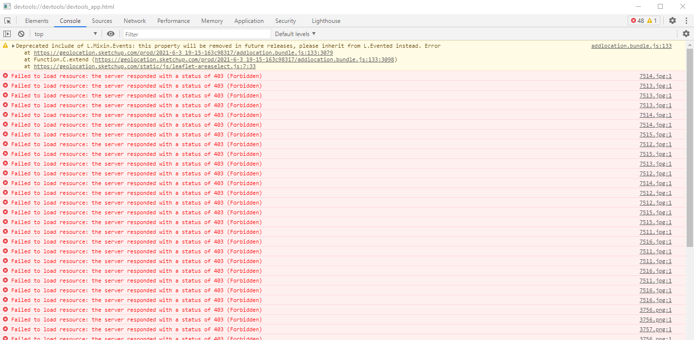

My colleagues & I are experiencing the same issue with geolocating since 06/04/2021 (last week). SketchUp Pro 2021 on Windows 10. Grayed out map, but if you do select a region and try to download Digital Globe data, we receive ā€œAn error occurred while downloading map tilesā€ and no geo-located layers are added to the project.
Below is what I see with ā€œShow DevToolsā€ in the grayed out map area. No difference if I choose a satellite view or map view, or if I toggle off ā€œHi Res Coverageā€
Thanks! A member of our support team James Elliot should be trying to reach you to see if this is perhaps due to a firewall or blocked port issue.
Thanks for the report and screen grab I will discuss it with my team.

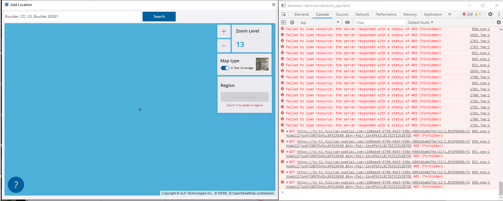

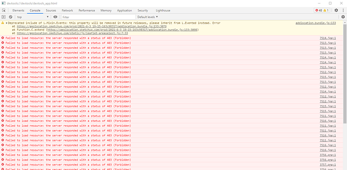

The Geo-location dialogue shows no imagery in either ā€œmapā€ view or ā€œsatelliteā€ view (grey area, with hi-res regions shown in blue), and if we do blindly try to select a region for import via the Digital Globe provider, we receive ā€œAn error occurred while downloading map tilesā€ failure. Very unfortunate, as we rely heavily on this functionality for our work flow.

@colin - I checked with our IT team, and they asked the following:
ā€œI was looking over your incident notes regarding SketchUp. I see you are trying to reach a GET https site from this screenshot. This should be allowed via our proxy server since it is regular https internet traffic. Usually what is needed for this to work is to configure the [company] proxy server settings into the application, in this caseā€
Is there a way to enable and configure proxy settings within the SketchUp application itself? I wasn’t seeing any likely candidates under Preferences. I did find the PrivatePreferences.json file for SketchUp 2021 and tried configuring the ā€œOnlineTestURLā€ variable, to no avail either.
A follow-up that we were finally able to get the geo-location functionality working in SketchUp 2021. Our IT Team had to do the following to get it to work with ZScaler Proxy:
Allow ports 3079, 3098. 8888, 8080, 5053, 50530
Do not SSL Inspect or require authentication for *.sketchup.com and also whitelist *.fulcrum-spatial.com
