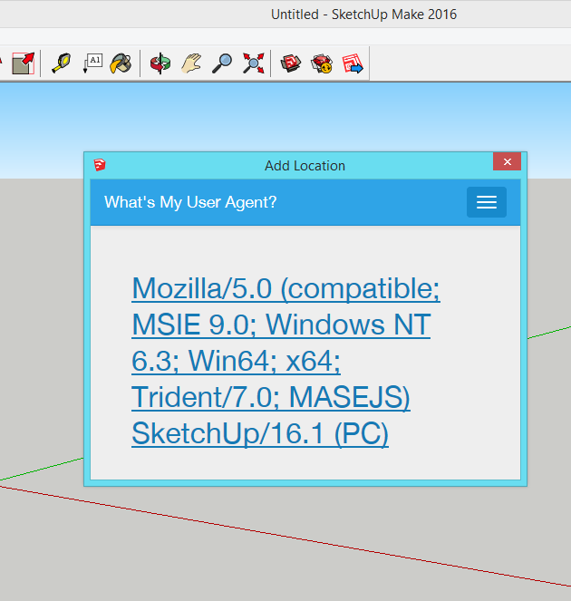

IE11 is supported (see Browser Support  |  Maps JavaScript API  |  Google Developers), but as the Microsoft article points out, it’s probably something to do with misreading the userAgent. If there’s any way you could hit ctrl-l in the add location window, and go to http://www.whatsmyua.com/ (what’s my userAgent), and past it, that’d be helpful.

@Barry I just followed your instructions.
“ua”: “Mozilla/5.0 (compatible; MSIE 9.0; Windows NT 6.3; Win64; x64; Trident/7.0; MASEJS) SketchUp/16.1 (PC)”,
“browser”: {
“name”: “IE”,
“version”: “9.0”,
“major”: “9”
“engine”: {
“version”: “7.0”,
“name”: “Trident”
“os”: {
“name”: “Windows”,
“version”: “8.1”
“device”: {},
“cpu”: {
“architecture”: “amd64”
It said 9.0 in SketchUp when I followed your instructions, while I possess Internet Explorer 11.0, which I think is really odd.
