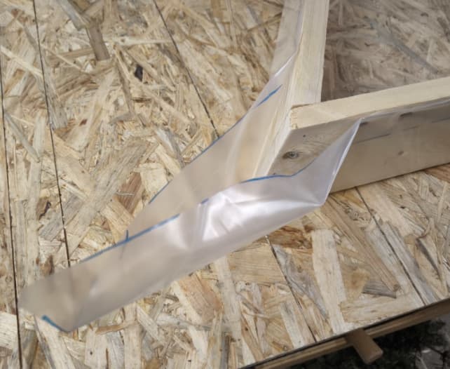

The first of over 100 triangles have been built and are covered with sturdy greenhouse film. I cover each triangle individually so that water that runs between them from the outside does not come into direct contact with the wood. Do you have any comments on this procedure?

Paul from geo-dome.co.uk seems to screw 3 triangles together before applying the plastic film.
Not sure if that has to do with waterproofing or if it’s an easier workflow..
I can’t find the video where he shows that.

Stapling the corners…
and the resulting centre of one of the hexagons …
