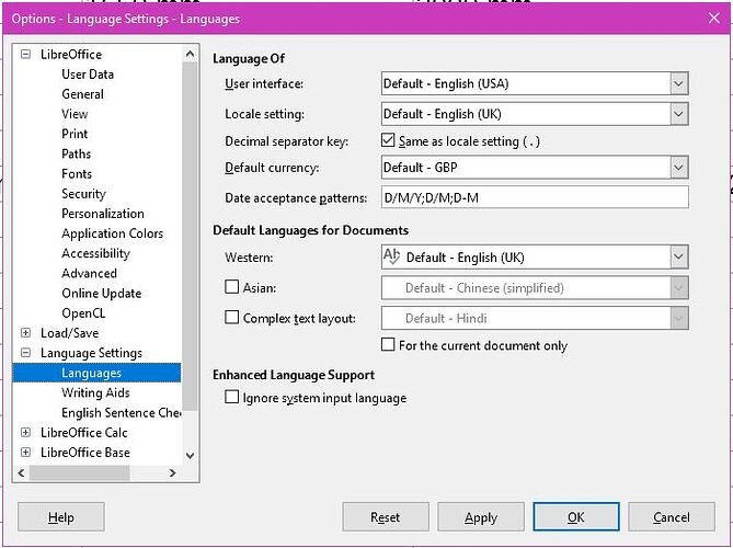

Try having a look at the language settings in your Spreadsheet app. It might be that the solution lies there. That’s as much as I can suggest.
