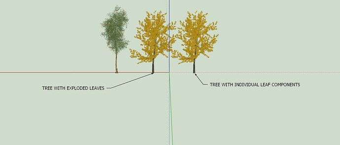

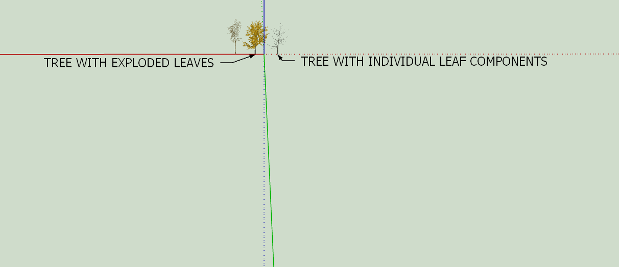

In my case I have exploded all leaves within my vegetation components (because I noticed that many tiny components are actually often more computationally expensive than one larger component, particularly where scaling and transforming is concerned). My trees now contain simple objects (trunk, branches, leaves on their own tag (called Details). Then the visible/invisible effect is consistent and controllable (by me) across all components, rather than being tied to screen resolution.
Zoomed in:
Zoomed out:
Yes. Explode the leaves so that they are not components, but are loose geometry.
Alternatively, edit the leaf to increase the size of the componet’s bounding box.
This should fix the issue. Let me know if it doesn’t.
(my post above explains further)
