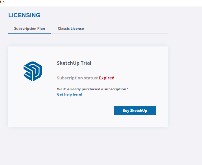

Just tried to open a file and it says my subscription has expired? I just paid for it a few months ago.
I look in My Products and don’t see my 2021 subscription?

I think I see what is wrong. The email you use in the forum has the free and trial things you showed. Your Pro subscription is under your live.com email address. If you have one of those, try signing in with that one instead.

Every 28 days you need to sign in to your Trimble account. It’s a thing tied to the subscription. I expect you ran into that sign in thing but then when you used the wrong e-mail address and changed your password (or tried to) things got balled up. The 28 days will come and go again and you’ll need to sign in after that. Might be a good idea to make a note and stick it on your computer showing the right e-mail address to use.
