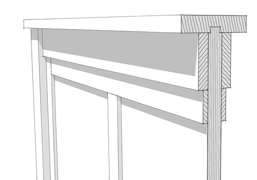

Not natively. You could use the Section Cut Face extension by TIG which is available from Sketchucation. It creates actual faces you can apply materials to. Instead of colors I used some sketchy patterns here.
