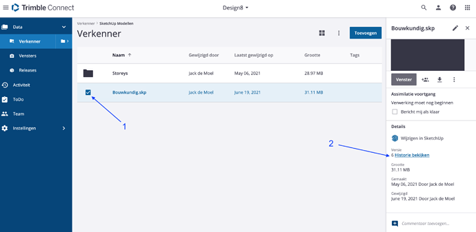

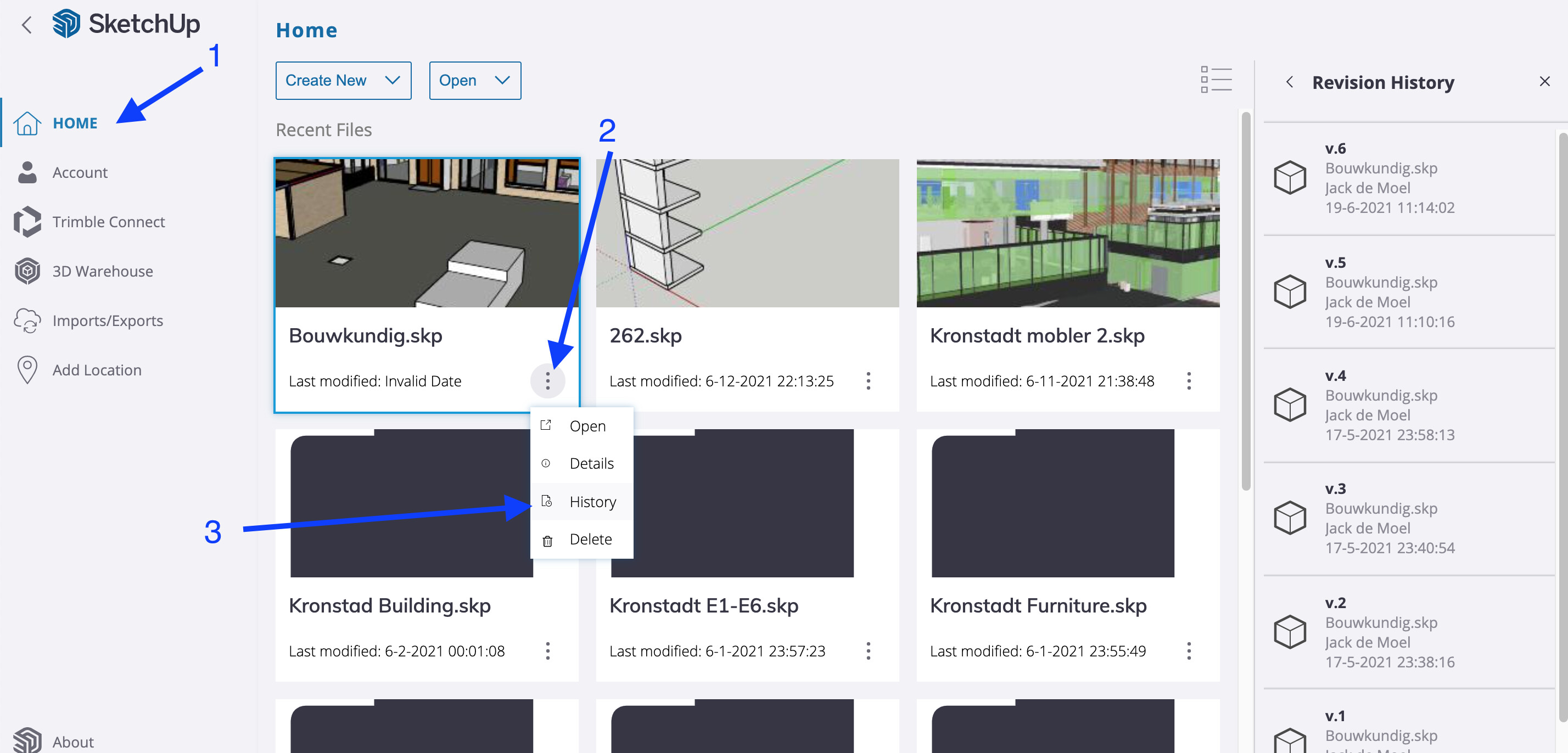

The version history is accessed in the home menu:
Web App:
or in the Project of Trimble Connect (connect.trimble.com):
