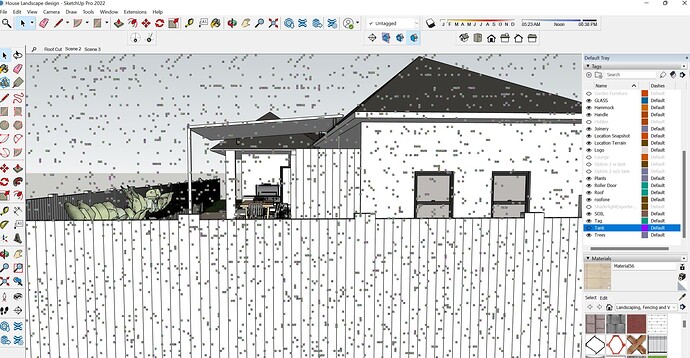

Hi, I have a sketchup file that keeps crashing in a way I’ve not seen before. Can anyone advice on what might be causing this? The screen goes pixelated & freezes & I have to force close. Happens every 2 - 5 mins. Hiding heavy objects gives a little more time but doesn’t solve a problem, it isnt a huge file at all either,

I dont have any file sharing services that I can use, are you able to suggest any ways I can try to find the issue myself? Here is a screen shot of what it looks like… I noticed it’s only pixelated on the render & not on the toolbars… do you know what that indicates?

That looks like a Graphic card issue. Check that the graphic drivers are up to date, don’t trust windows to tell you they are.
Definitely something graphics card related. If it’s not the drivers , I would be concerned there is a hardware fault

I think you might be right as Ive opened it on another computer & havn’t had any issues yet.
I’ll see if I can update it & if that helps
