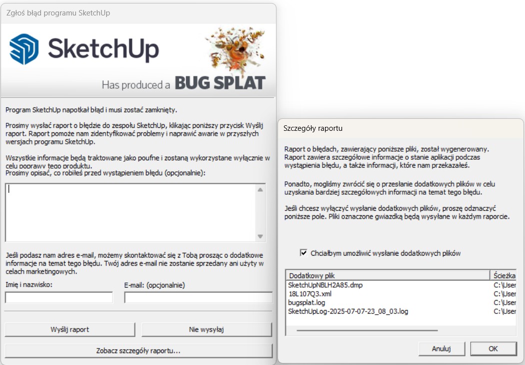

I’ve got a qutie heavy file (a lot of geometries) and sketchup crashes even when I want to activate all the tags (make it visible).
I attach screenshot about files mentioned in bug splat details.
Could you please tell me where should I look for a root cause and how to do it?
Thank you in advance for all your help!

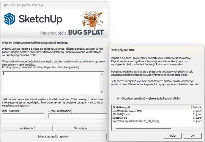

Here are files from bug splat.
My graphic card is: NVIDIA RTX A2000 12 GB
I sent the reports a few times but without my name and email
None of those are what I asked for. Share the SketchUp model file.

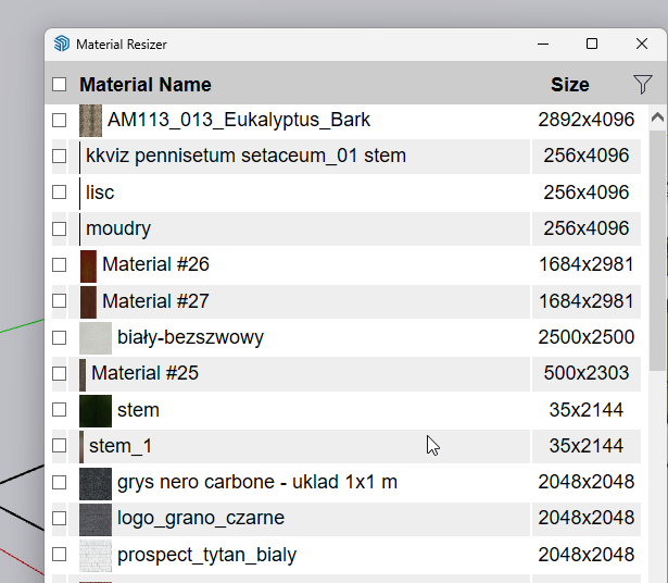

There are some excessively large texture materials in your model. They can be reduced and in some cases they could surely be replaced with simple colors.
See if this version behaves better.
Thank you for the update of the file. I can really feel the difference when I’m moving the camera. I can start even the render.
However I can see that some details are missing - like quality of leaves. Which should be obvious because you reduced the file. Is there any way to keep previous texture materials?
