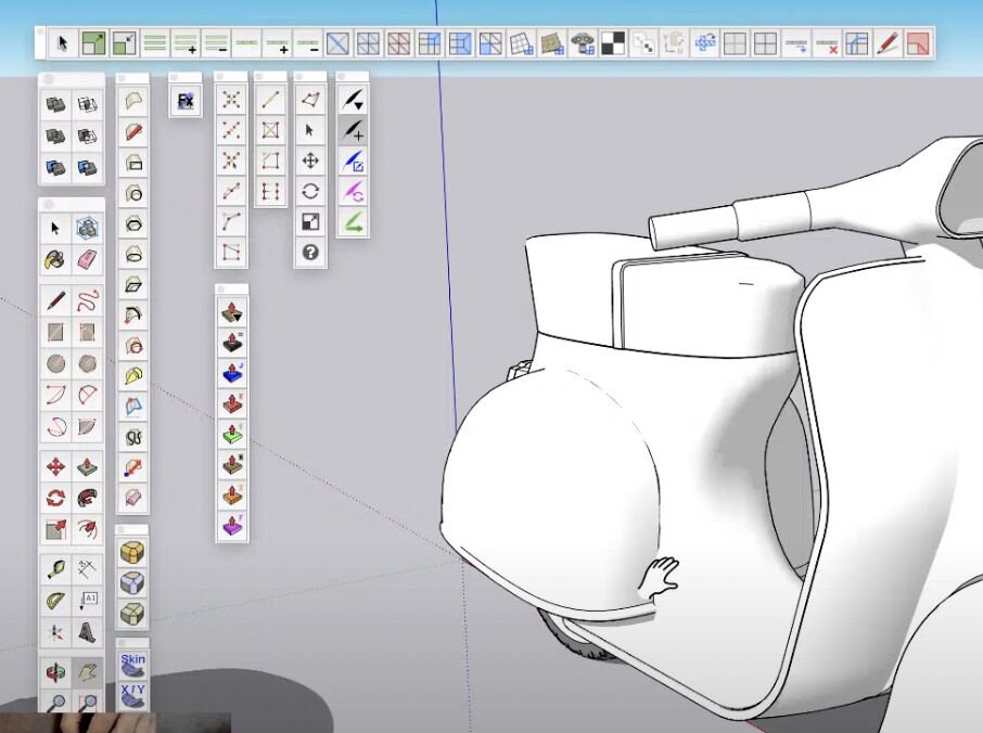

Here’s a screenshot from Tyson’s modeling stream yesterday, where he was using a lot of extensions:
At one point he was trying to locate a particular tool in the long horizontal palette, and no help tips were showing up. I wanted to type in the chat about how that doesn’t work on Mac, but that palette is a bit too big to have it be vertical, so it wouldn’t have helped.
To get the palette to be vertical, drag it to the left of your screen, and it should rotate to vertical.
