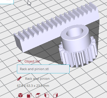

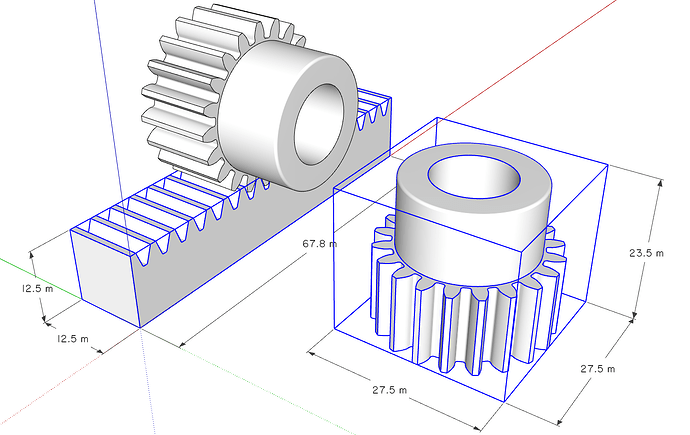

From an earlier thread:
Two components selected in the model before export.
The resulting .stl as seen in the slicer.
Screenshot - 6_11_2024 , 11_32_09 AM
Dave was faster. so yeah, simply select your groups / components before export.
