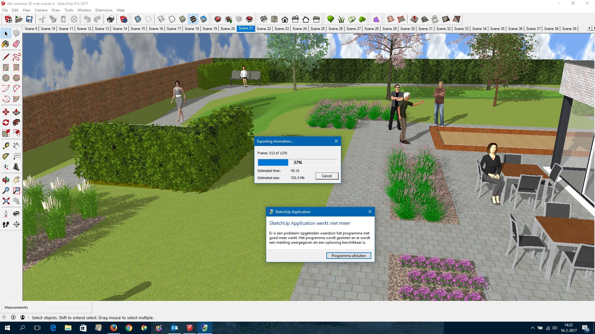

Thank you both for your help. But untill now no result. Let me tell you what I have done. I downloaded the latest driver.
Exporting the animation however did not work well. It stopped after 37%. After that I copied the model into a new file. Again I exported the animation. This time it stopped at 36%. For the third time I tried but again it stopped at 37%. I got the message that Su does not work anymore. So I had to stop. I do not know what I am doing wrong.

I updated SU 2017 as in your reply. This also did not work. I have Ram 6,0 GB working memory.
I also looked at the log. I see a lot of things I do not understand, so I will ask someone to look at it. Now I made a new animation with less scenes. That helped.

which is not very much, check w/ someone computer savvy if uprgading RAM of the notebook is possible (if botoom has a lid it’s very likely).
All the entourage components you use, especially plants, seem to be fully 3D. They will make your model unnecessarily complex. As you were able to export if you turned shadows off, this might be the problem.

Thant’s correct. It worked without shadows.
Thank you.
for shadows you may want use much lighter 2D components in combination with the component option “Always face Camera”:
