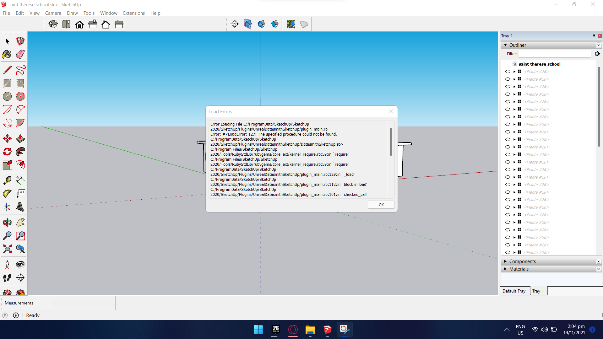

Error with datasmith
how do i fix this
Error C:/ProgramData/SketchUp/SketchUp 2020/SketchUp/Plugins/UnrealDatasmithSketchUp/plugin_main.rb
Error: #<LoadError: 127: N\xE3o

Erro ao carregar o arquivo C:/ProgramData/SketchUp/SketchUp 2020/SketchUp/Plugins/UnrealDatasmithSketchUp/plugin_main.rb
Error: #<LoadError: 127: N\xE3o foi poss\xEDvel encontrar o procedimento especificado. - C:/ProgramData/SketchUp/SketchUp 2020/SketchUp/Plugins/UnrealDatasmithSketchUp/DatasmithSketchUp.so>
C:/Program Files/SketchUp/SketchUp 2020/Tools/RubyStdLib/rubygems/core_ext/kernel_require.rb:59:in require' C:/Program Files/SketchUp/SketchUp 2020/Tools/RubyStdLib/rubygems/core_ext/kernel_require.rb:59:in require’
C:/ProgramData/SketchUp/SketchUp 2020/SketchUp/Plugins/UnrealDatasmithSketchUp/plugin_main.rb:122:in _load' C:/ProgramData/SketchUp/SketchUp 2020/SketchUp/Plugins/UnrealDatasmithSketchUp/plugin_main.rb:105:in block in load’
C:/ProgramData/SketchUp/SketchUp 2020/SketchUp/Plugins/UnrealDatasmithSketchUp/plugin_main.rb:94:in checked_call' C:/ProgramData/SketchUp/SketchUp 2020/SketchUp/Plugins/UnrealDatasmithSketchUp/plugin_main.rb:105:in load’
C:/ProgramData/SketchUp/SketchUp 2020/SketchUp/Plugins/UnrealDatasmithSketchUp/plugin_main.rb:894:in <module:Datasmith>' C:/ProgramData/SketchUp/SketchUp 2020/SketchUp/Plugins/UnrealDatasmithSketchUp/plugin_main.rb:52:in module:EpicGames’
C:/ProgramData/SketchUp/SketchUp 2020/SketchUp/Plugins/UnrealDatasmithSketchUp/plugin_main.rb:14:in <top (required)>' C:/Program Files/SketchUp/SketchUp 2020/Tools/extensions.rb:197:in require’
C:/Program Files/SketchUp/SketchUp 2020/Tools/extensions.rb:197:in load' C:/ProgramData/SketchUp/SketchUp 2020/SketchUp/Plugins/UnrealDatasmithSketchUp.rb:51:in register_extension’
