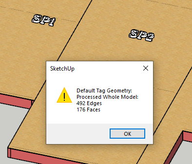

Every time I click on 3d generated text in my file I get that error.
I’m using Sketchup Pro 2022. I used pretty much only pull, move and copy tools. Plus making 3D text. Now suddenly I’m getting this error on all the 4 texts in different groups.

I’m not seeing that message in SketchUp 2022 which would imply it’s coming from an extension you have but I don’t. What extensions do you have installed? Might be worth temporarily disabling them to see if the error goes away. Have you tried closing and restarting SketchUp? Did you install SketchUp Pro correctly? This requires right clicking on the downloaded installer and choosing Run as administrator.
BTW, your profile says you are using SketchUp Free (web). Since you are now using SketchUp Pro, please correct your forum profile. That information helps us help you.
I got the error message. No idea as to the cause, but it went away after I ran ThomThom’s Cleanup plugin. Might be from an extension, but I don’t use many…Nothing in Ruby console.

Another piece of evidence: I did a string search of the SketchUp app, and (at least on Mac) there is no message that matches what you showed. That reinforces the notion that it is coming from an extension plugin. Do you have any 3DText editing extensions installed (e.g. ThomThom’s 3D Text editor)?
I don’t, and I get the message too. I don’t know what CleanUp fixes but it gets rid of it. I tried switching off some of the options (like geometry to layer 0 and edge materials) but couldn’t get the message to reappear. Deleting all tags got rid of the message, too.
I still have not been able to make it happen on my Mac. There may be some subtle difference between Mac and Windows? Or perhaps the locale setting affects it?

After you get rid of the message by renaming it to Tekst
You can rename back to TEKST.
So, I guess there should be some kind of invalid character in the original Tag name…

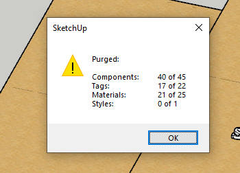

Yet one about Cleanup: If I run it without the “Purge unused” option, the error message remains. But running the native “Purge unused” does not fix the issue. Also, the issue remains if I run Cleanup without purge, and purge with native tools afterwards.
Go figure. Would need more sophisticated tools…@ThomThom, what does CleanUp do behind the scenes?

But here some “interesting” thing happened with your file, because as I discovered (see my post above): After you get rid of the message by renaming it to Tekst You can rename back to TEKST.
I tested this out a bit more and while the rename of the tag does work, the error came up again and was fixed again with a rename.
Another thing as I work with the file is that when renaming the tag “tekst” it doesn’t update the name even though it fixes the error. It updates the name only after I click on it again.
