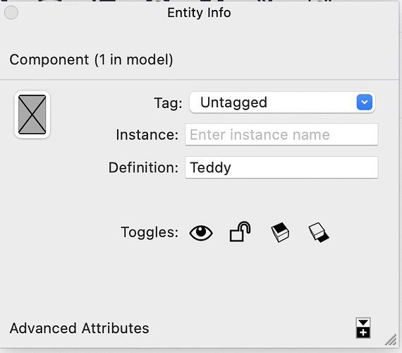

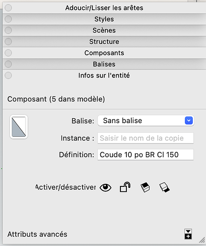

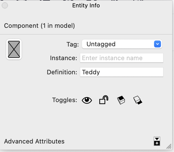

I have always used a mac as my personal computer and I don’t remember ever seeing this on my mac, so I don’t think it’s just a difference between the versions, but I could be wrong I suppose. I can’t find the materials, styles, tags, any of those other drop down tabs that are usually below the entity info. Here are the pictures of the entity info box on my old computer vs the new one. I feel like this is an easy fix but I can’t find it anywhere.
The window expands when you click on the small arrow icon in the right bottom corner.

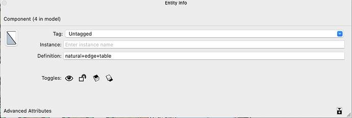

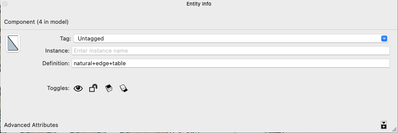

There were two things in the bottom right corner that looked like possible arrows. One pulled up some additional price type info that was only available when I selected components, and the other just allowed me to drag the window bigger horizontally. Here are pictures of both results. It’s also doing it on my personal computer all the sudden, which I don’t remember being the case, so I’m pretty confused at this point.

Entity info works the same on the Mac in this regard. In fact your screenshots show they are totally identical. The other palettes you can find in the Window menu: Materials, styles, tags, etc
What exactly are you missing? In each of your screenshots you show have a (not-solid) component selected. I don’t see anything missing your screenshots that I would expect to see in Entity Info on Windows.

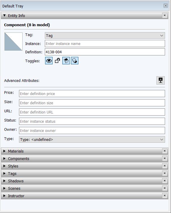

I guess I’m missing all the stuff I would expect to see on windows? I thought the mac version displayed like the windows version when I opened the entity info box. How do I get into the materials, components, styles, tags, shadows, scenes and all of those other drop downs on the mac version? It looks like they are all a part of the “default tray” along with the entity info itself. So how do I get my full default tray to show up?

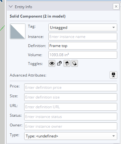

Entity Info shows the same thing in your Mac screenshots that you’d see in Entity Info on Windows. Here’s Entity Info on Windows witha component selected and the Advanced Attributes expanded.

So you’re really not talking about Entity Info, you are talking about the other windows that appear in the Default Tray on Windows. You can open any and all of those windows from the Window menu and dock them together but there is no tray on Mac. Slide the stack of window over to the right and, if you want, make the main window narrow enough so those utility windows are not covering the model space like the Default tray would normally do on Windows.
Oh that’s so weird! Why would they make the interface so different like that? Seems like a pain in the ass extra step. I was so used to being able to pull up all of that with a quick right click on the item, then closing out the windows when I’m done. Now I guess I have to leave the dock of options open all the time and let it populate based on whatever piece I have selected? Do you know if it’s always been like that on the mac and I’m just being delusional, or if that was a change change on a particular version?
Operating system differences. It’s always been that way since 2016 when the tray feature was added to SketchUp on Windows.

On the Mac they are all separate windows. Open them from the Window menu.

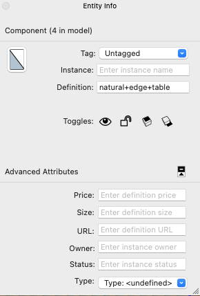

On some windows, at the bottom right, there is a small triangle pointing down with a + sign that allows you to open an extra panel with advanced information or attributes. Once expanded, the triangle points up and the + sign becomes a - sign, telling you that you can close this extra panel.
These windows can be stacked together for a neat setup.
See attached screen capture showing a few windows with the Entity Info opened.
