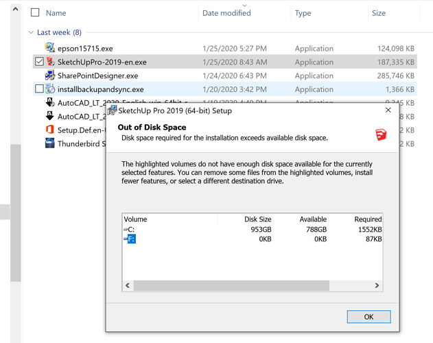

Can you show a screen shot of what you are seeing?
![Capture.PNG|437x499](upload://NcJmXAJzEb81XCP6XhI3u8
9Aez.jpeg)
I don’t know for sure if installed correctly. I just followed prompts for most automatic install not confident to do anything custom.
It does the same thing as a separate tray.

For some reason it’s trying to use an unused volume F. It ignores my click on C so can’t get it to repair.
That’s weird. I’ve never seen anyone report that before. Might try rebooting the machine. Do a cold reboot (power off completely).
