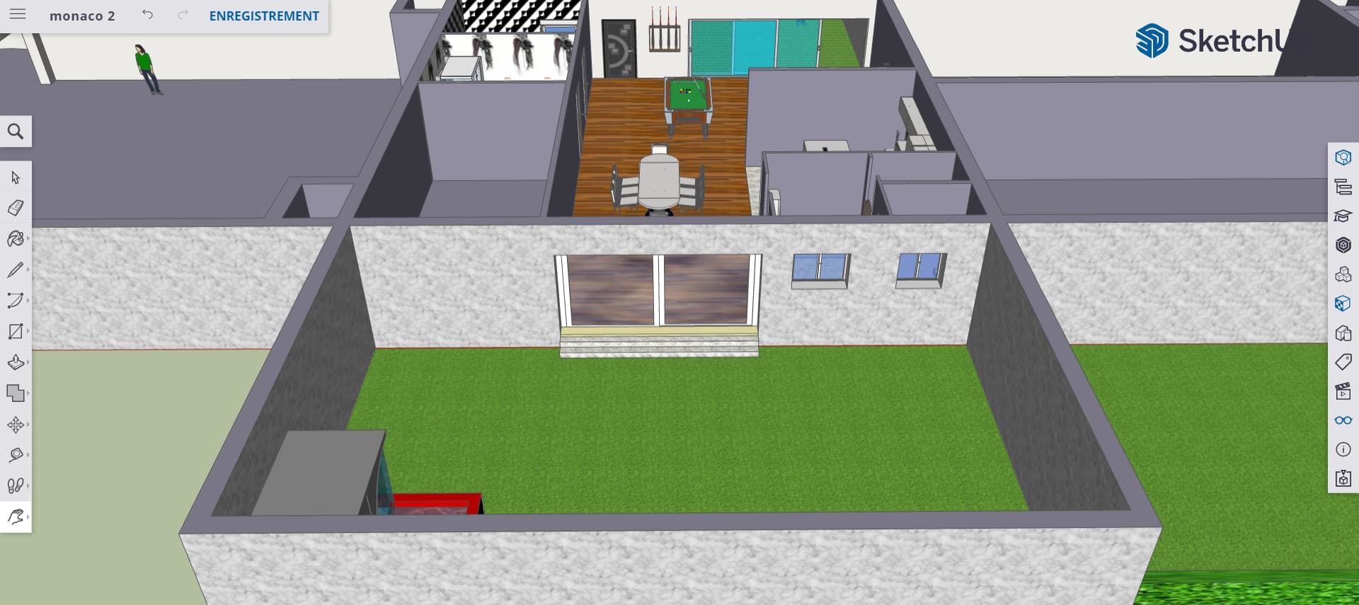

Looking at your screen shots I would say that you should also wait to apply materials until your model is nearly complete. The materials load down the model and make it more challenging for your computer to handle it.
