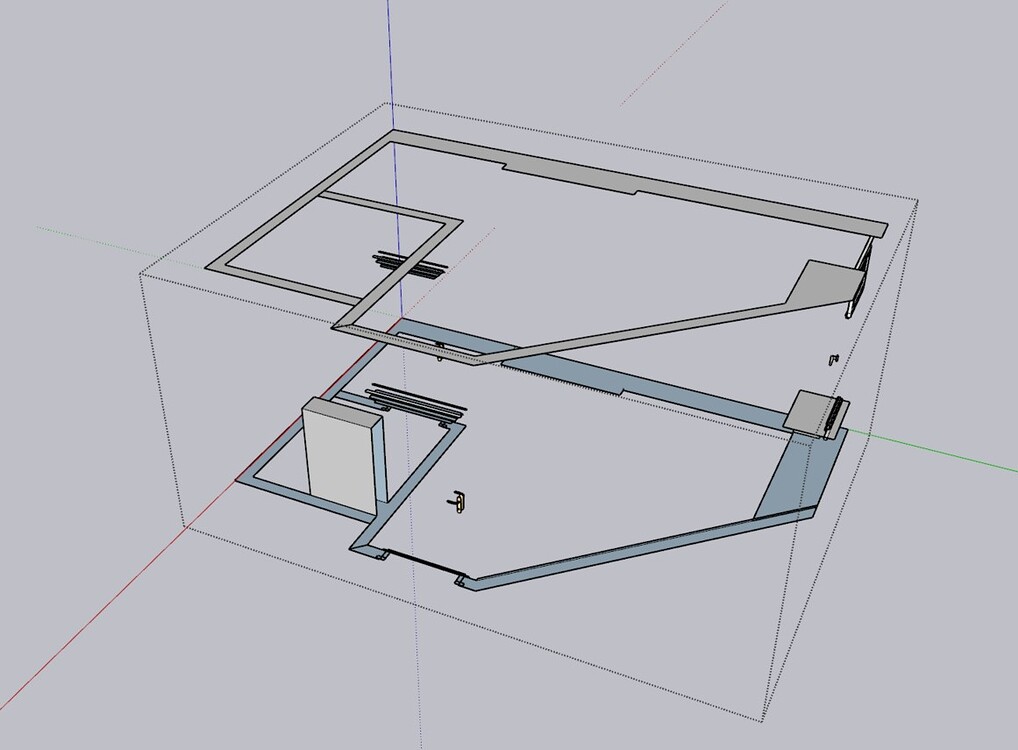

The extension is not slicing properly, or at all really, will just create the top and bottom faces of the group, anyone has an idea why is this happening?

Hello,
Thank you for getting back to me, I have been using it just fine for the last 2 months and suddenly is looking weird.
Ive also notticed that my models look pixelated so it could also be a graphic problem but after checking a lot of tutorials I still dont seem to find a solution for either problems.
Can you post your model? Your last image makes me wonder if your model is not very far (kilometers) from the model origin point. Have the axis showing in your screenshots been modified?
