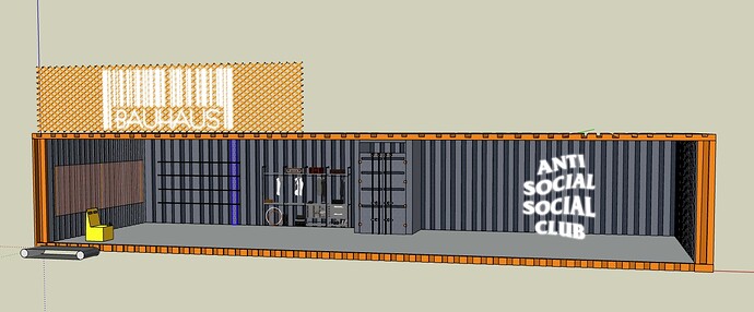

Hi I’m new here, so I was using a free web version to create a pop store, then I downloaded the app on my iPad Pro 11 m1 2 TB unit and subscribed to a plan. I tried editing the file that I have made from the free web version, but it crashed and now the file is empty. I don’t know what to do as the file is important and it was a lot of work to recreate it.
Were you working on a copy downloaded from the web version, or is it all stored in Trimble Connect? Is it possible to go back to the web version and download another copy?
It automatically sync on my iPad once i logged in on my account, and it was on Trimble Connect. I was able to open it on my iPad then when I use rotate and zoom, the artwork banished and got stuck with an empty one. I tried reopening it on the web but still the artwork doesn’t show. kindly see the attached for reference
