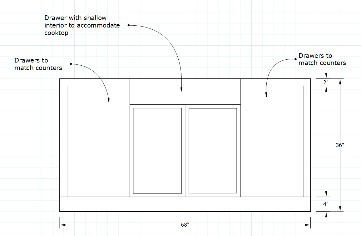

Just guessing but I imagine your client will have an easier time “reading” a 3D perspective view of the island.
In LayOut, something like this.
