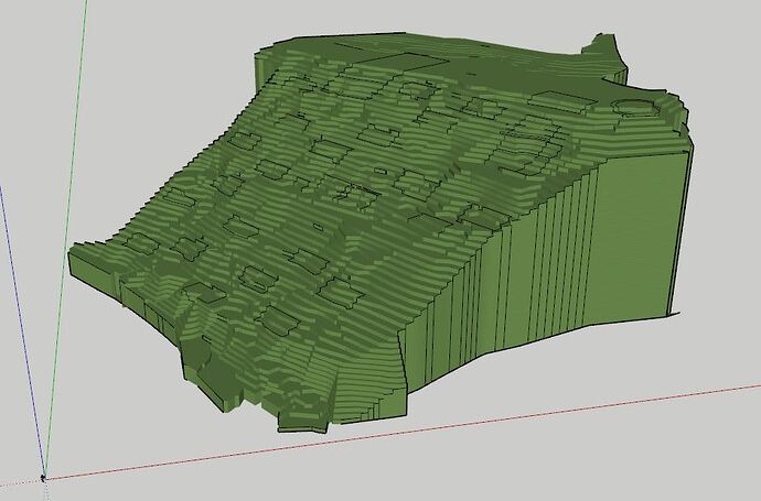

HOW CAN I MAKE EDGES VISIBLE? I HAVE TRIED UNSMOOTHEN EDGES, VIEW HIDDEN GEOMETRY TO EVERYTHING. ITS NOT WORKING. HELP!!!
Untitled.skp (942.2 KB)
LOOK AT YOUR TAG PANEL THERE IS A TAG NAMED CONTOUR THAT CONTAINS ALL YOUR EDGES. THIS IS NOT A GREAT PRACTICE, RAW GEOMETRY SHOULD NOT BE TAGGED.
I GOT IT. THANK YOU SO MUCH ![]()
