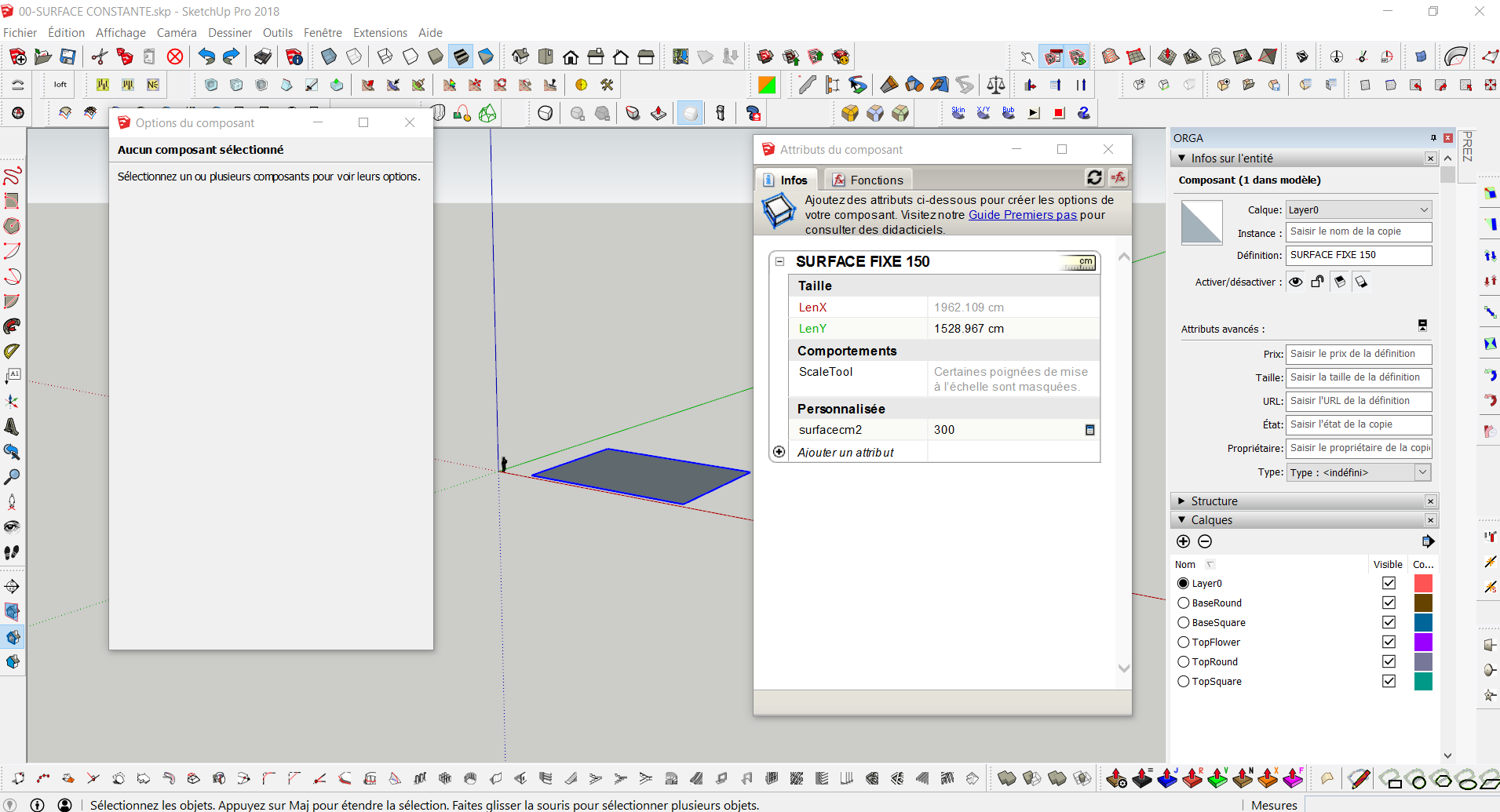

Hi,
I am preparing a serious training (all over France, including videos) for state architects, town planners, urban designers and technicians.
I planned to introduce dynamic components with a simple constant area surface with variable on red axe (choice of the surface enable for user in option tool).
No problem for creation and manipulation but as soon as I open the attribute tool, the option tool is not working : no name of the component neither image, neither option : “no component selected”.
I must close SUp and re-open to access the options but same problem if I open att tool.
I am on W10 with a 2018pro version AND IT IS THE SAME IN ALL OF MY PRO VERSION FROM V8-13-14-17-18 ON ALL MY COMPUTERS.
I test with the native collection of D.C. same problem…
Did it happen to anyone I don’t remember this problem when I used DC time ago ?

Here some screenshots from some of my pro versions.
plantage%20comp|690x388
