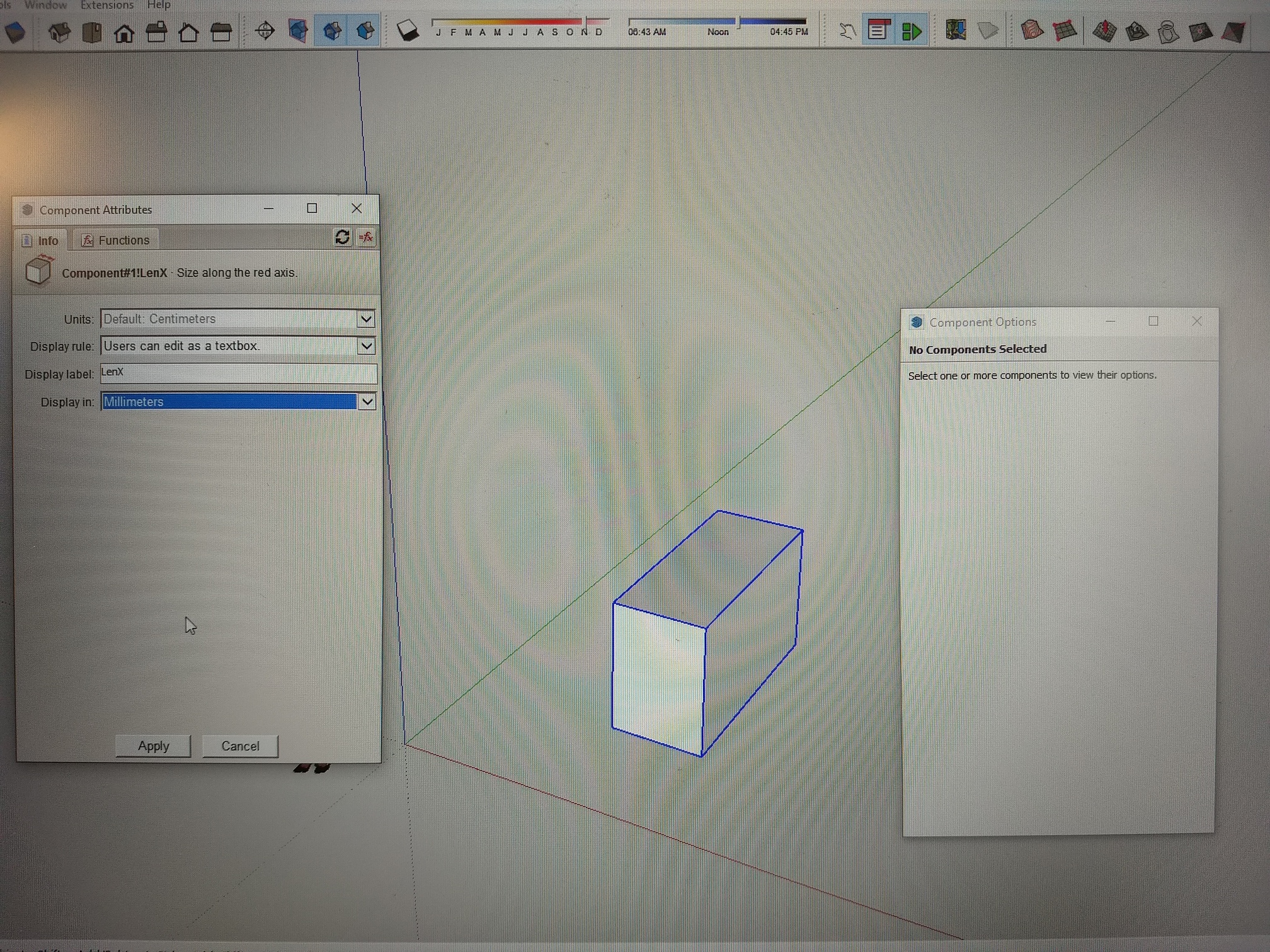

Thank you for your reply Anssi. Please see the image attached. Even when I have made a component and I select it, it does not show on the component options window (no components selected).

That is because the component has no attributes. You must create attributes and make them visible/editable in the options window.

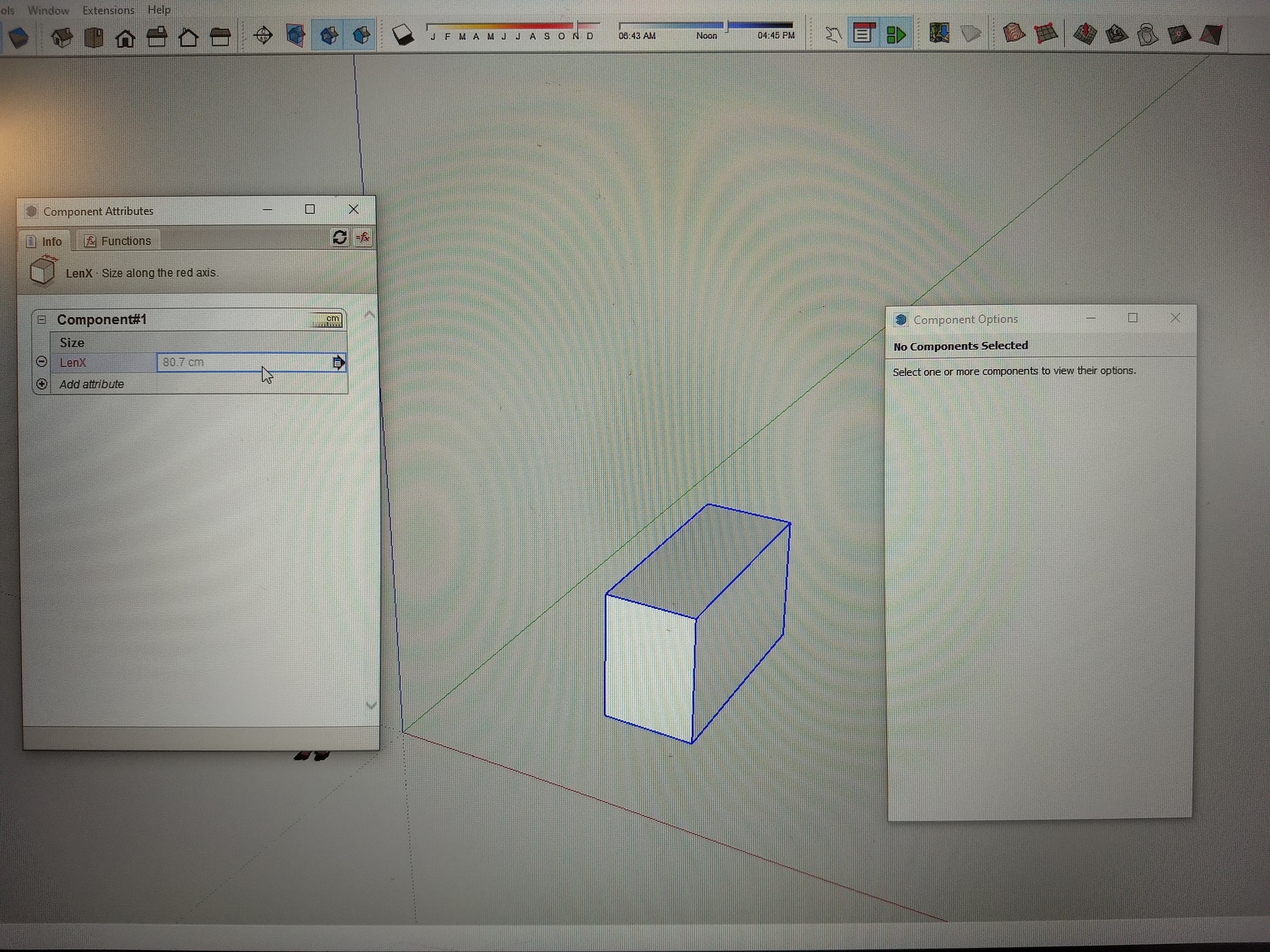

You will see that even when I have made the box a component and added 2 attributes: LenX and LenY it still does not show up on the component options window. I went to the details button and set the display rule to: users can edit as a textbox
Hi Dezmo, thanks for your reply. However, I have watched the video and other skillbuilder videos from Sketchup on Youtube but my problem is that my DC is acting weird. You will see in the image that even when I have added attributes it still does not show up on the component options window.
That’s probably because you have not made anything variable for a user.

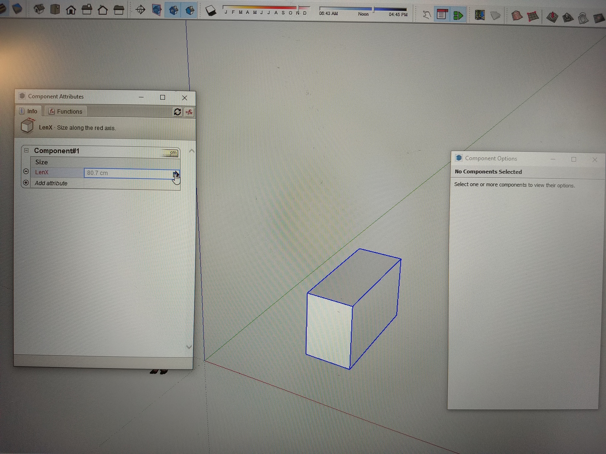

Thanks for the video dezmo. Please take a look at my images. Firstly, when i make the component it does not show up as a thumbnail in the component options window, secondly when I add the attributes it does not show up on the attribute window and also disappears from the attributes list. Finally, when i make the attribute editable, it still does not show up
The issue I am having
It’s a known issue.
