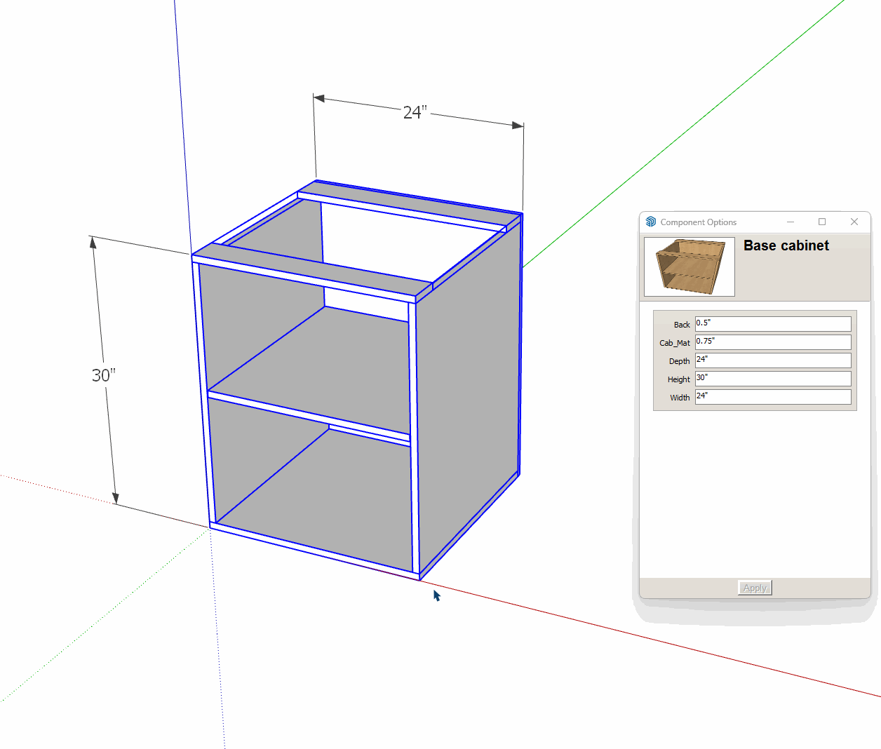

Hello everyone. I am in need of someone to help me figure out why I seem t be having issues with the dynamic component cabinet I have built.
Very basic box design where I have created options for with, height and depth. After building the model and tested the options with varying sizes with no issues.

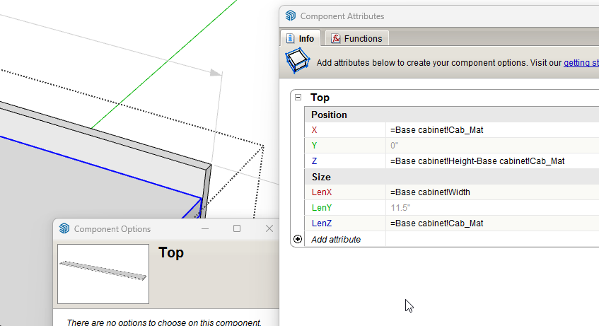

I have saved it to my local collection, open an new project, select the component and place it. Now when i go to the component option and change the size the specs are all over the place and requires me to go into the attributes and replace the coding to what it was when i built it and had no issues.
Note this will also effect other components that i bring into the project.
Is there something I have missed? I was a long time user of 2018 desktop version and hadnt had these issues in the past. Is there something within 2025 I am doing wrong?
Please Id really appreciate the help.
I have attached the two cabinets.
Base cabinet.skp (15.2 MB)
Wall Cabinet.skp (15.2 MB)

I do see a problem with the wall cabinet and it appears it’s due to using copies of the base cabinet components. You should use new components for the wall cabinet.

I think it’s better to do this. Making the components unique won’t change their names in the DC. I’m in the process of rebuilding your wall cabinet now. I exploded and remade all of the wall cabinet components to ensure there’s no connection to the base cabinet.
Have a look at this version of your wall cabinet. Make sure you import it into a SketchUp file so you don’t have an extra level of nesting.
