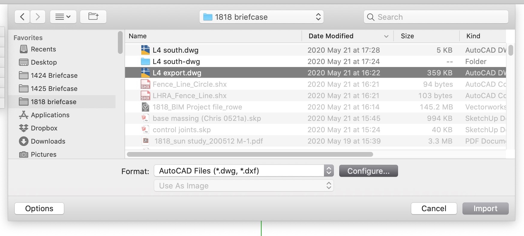

Here are a couple of screen shots. Clicking the Configure button works for the other file types - it is only unresponsive for the DWG/DXF file type. Feels like something is missing from the library. (Note that I did a clean install of Sketchup while trying to fix this - to no avail.)
What does the Configure button do? On the PC all the import settings are behind the Options button. What does the Options button do on the Mac? Just curious.
It just pops up the import dialog, it could be that it is hidden somewhere after disconnecting a second monitor. You could try resetting the workspace [menu]SketchUp->Preferences->Workspace
I finally fixed this issue by undertaking a second clean install of SU (I must have missed a corrupted prefs file the first time).
