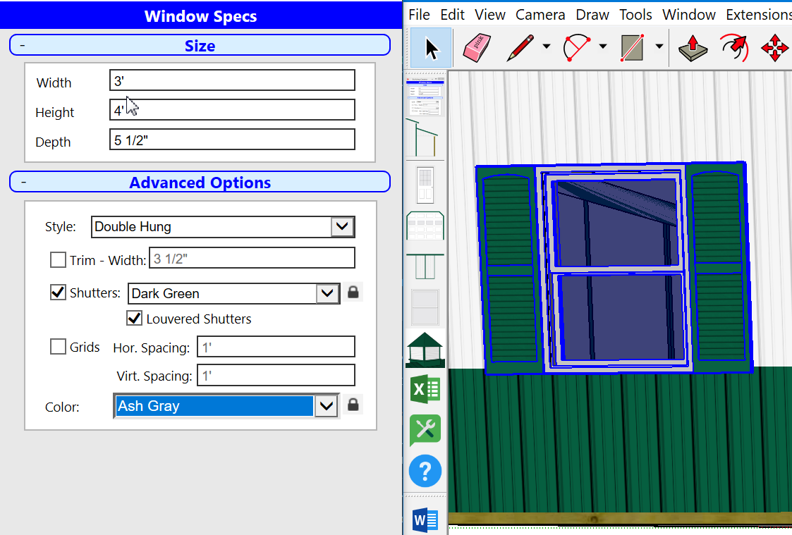

The Building Creator extension does all that for you automatically!

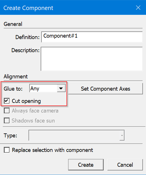

First select your window geometry, right click, and select create component.
In the box that comes up make sure to select glue to any, and Cut Opening.
Although OP is using the Free, non-plugin version. I am interested in the plugin (in the first post). The link does not work, but I found another post of yours. Is this a Windows-only plugin?
Fixed the link.
Windows only as in not Mac compatible, although I’m working on a Mac compatible version.
But not window only as in creating various types of openings (windows, walk doors, overhead doors, and barn doors in 10 different styles). Send me a PM. I’d be happy to do a demo, or you can download the free trial and check it out.

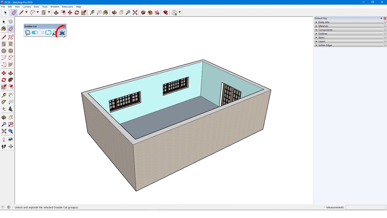

However, right at the end of the video he briefly mentions an extension specifically designed for cutting through double walls. Just now starting to explore it, and while I do perhaps you’d like to as well.
You can get the extension here:
https://extensions.sketchup.com/extension/6bc14ba6-bbc7-4590-a935-c22eee3d2e46/double-cut
The extension has a free 15 day trial, and a permanent license is $39.
Read more here: Make SketchUp components cut through thick walls - Double-Cut
They have three tutorial videos:
I’ll comment further once I’ve played with the extension for a bit. Do the same if you wish.
