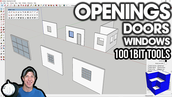

Have you checked out the 1001 Bit Tools extension (free)?
In addition to the FlexTools extension I tried to give you earlier, Bit Tools has some handy hole cutting and window/door (w/ frames!) routines that are pretty good. Note, although this extension has not been updated since SU 2015, it seems to play fine on SU '19 and '20.
Check out these 2 YouTube pieces from SketchUp Essentials …
Easy Openings, Doors, and Windows w/1001Bit Tools
Learn how to use the free SketchUp extension 1001Bit Tools in order to create different kinds of openings in walls in SketchUp!
Cutting Holes? Fixing Opening Issues
This video will talk about some of the common issues people have when trying to cut holes in flat walls in SketchUp!
Thanks @Beamer2 - no I hadn’t heard of this extension to now. I’ll check it out and report back, and watch the videos you’ve provided too. Appreciate it.
Hey Beamer, wanted to check back in to thank you for your suggestion and report it looks like the solution for me. I haven’t mastered it yet of course, but I’m working my way through Justin’s videos and getting the general idea. Looks good to me, I’m going to stick with this for now.
