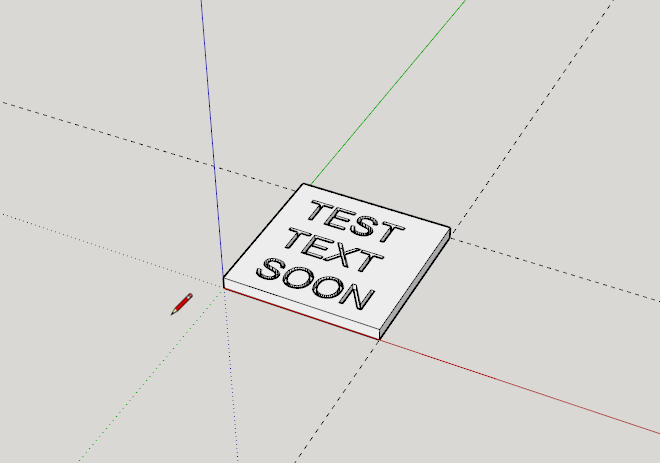

I’ve created maybe 100 objects without problem. Yesterday I added 3D text to a new object, but after a few manipulations of the text I found the pencil tool would not create a line on an existing surface. Same result with the rectangle, but the circle continued to work. I closed the drawing and opened a new one. Same problem. I closed Sketchup and then reopened Sketchup and opened an old (and different) drawing. Same problem.
To be clear, the tools work for a new object in a clean, empty design, eg, draw a new line. But after the first line is created, the line tool will not draw a new line that is connected to, crossing, or touching an existing line. But it will draw a new line in open space.
Can you share one of the files that this is happening to? Just upload the .SKP file, so we can take a look and help find a solution.
TEXT TEST.skp (132.1 KB)
I have checked again and I can’t create a deliberate line in space in this (and other) drawings. However, if I move the cursor quickly and click randomly, I get short line segments. I looks like if the clicks are close together in time, like .3 sec or less, I get a line segment.
Hmmmm… I just tried drawing some edges in your model and have no trouble.

I was afraid of that. I am having the same problem in old drawings made prior to this issue showing up. I saw in other postings that the video card was a suggested problem, but this is a relatively new gaming laptop (300GB SSD, 2TB HDD) but just a simple Intel graphics chip. The OpenGL box in preferences show “fast feedback” and “0x” antialiasing sampling.
I assume that reloading Sketchup is the next step.
I would start by updating the graphics drivers. Keep in mind that Intel graphics are frequently problematic in that they don’t adequately support OpenGL.
I’m curious. Have you rebooted your computer since the issue occurred? Some times I just put mine to sleep.
■■■■, rebooting never occurred to me. Reloading Sketchup seems to have solved the problem for now.
I am going to look into the graphics drivers issue. Lenovo keeps wanting me to install some gaming video stuff, which I decline.
The last two times I had the “lagged selection tool issue” with my SU …reboot repaired it. Putting my computer to “sleep” seems to be causing some kind of issue that I don’t understand.
