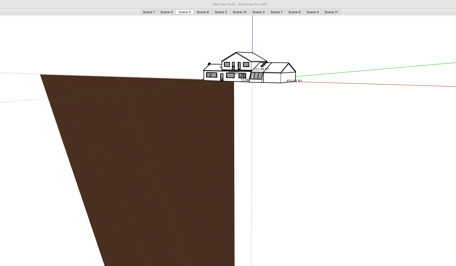

Well, new wonders! Right now the selection rectangle is working for a while, but new weird effect is happening, see photos. Is that a symptom you recognize.
Thanks…
I’ve not seen that myself, but it seems typical of what on Windows would be graphics card/driver problems. Sorry, I’m out of my depth here in terms of what to do about it.
