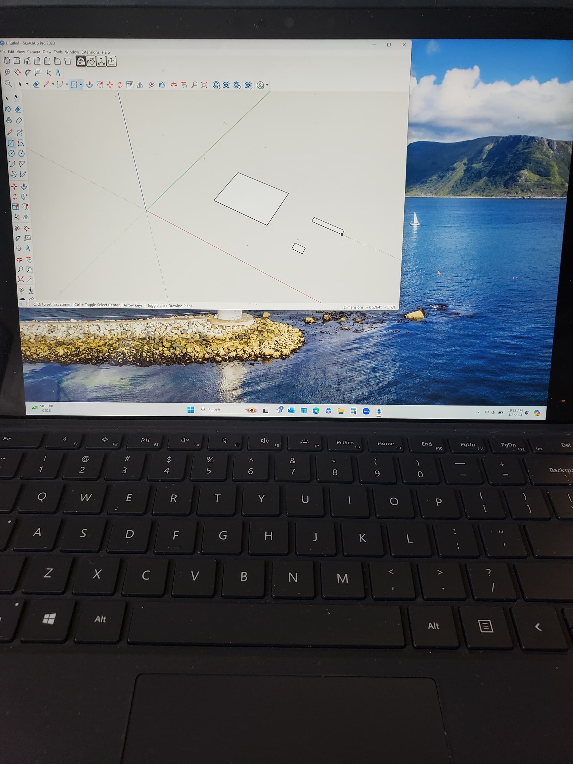

My dimensions box is too far over and i can’t see the part of my last measurement.
Show a screenshot of what you are seeing. Are you still using SketchUP 2021 as indicated in your profile?
Again, are you still using SketchUp 2021?
To what do you have display scaling set? What happens if you maximize the application window?
You can always move the Measurements window elsewhere if you want. View>Toolbars>Measurements.
No it’s pro 2023
Please update your forum profile.
I moved the dimensions box but it’s still seems like the dimensions are too big for the box.
