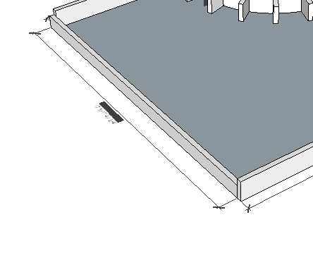

Suddenly I have been getting unreadable dimensions. even when I go back to previous files from yesterday, last week and last month. The same dimension issue., I have gone into the model info/dimensions and change fonts and other setting with no change in the display. I need help…
image of issue

It’s been some years and SketchUp versions since I’ve seen something like that. As I recall it had something to do with the graphics drivers back then. Did your graphics card get a recent update?
What does it look like if you make the dimension text parallel to the screen?
Most likely your graphics card and/or driver lacks support for OpenGL 3.0
Try updating the graphics driver.
See: How can I update my computer’s graphics driver? — SketchUp Help
