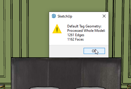

“Default tag geometry” is that a plugin or a script you use to explore files?

I used some basic techniques to fix your model. To correct the tag usage I used a plugin from Sketchucation called Default Layer Geometry. To purge the unused stuff from the file I used another plugin called Purge All, also from Sketchucation. You can purge unused by going to Model Info>Statistics and clicking on Purge Unused. The plugin does the same thing. I use it because it also gives a report of how much was purged.
For tag usage, the best thing is to make sure you are working correctly in the first place and leave all edges and faces untagged. Check objects you might import into the model before you import them. Open them in a separate file first and clean them up. After they are clean, add them to your project.

Why i leave the edges and faces untagged ?
Can i do some groups with the edges and faces ?
For example : Group : Wall west ? o it’s better without nothing ?
