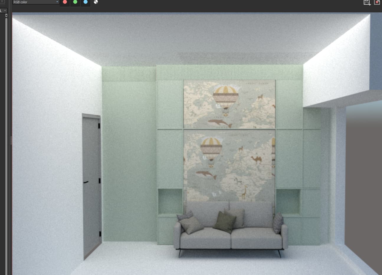

Greetings everyone, I’m facing difficulties aligning the colors between the sketch and Vray render. Despite attempting adjustments in Photoshop with RGB values and various methods, the color inconsistency persists. I have attached the values and relevant details; please advise on the issue. Sketchup 2022 .

Looking at the first image in this thread, what is the colour temperature of your Vray lights?

This Render is without using anylights
I have used 6500 scalar with 30 intensity
6500 scalar with 60 intensity
Please guide what instensity and k should I use to achieve that color

your light is too warm, it needs to be cooler (maybe around 4500K~5500, looks like yours is more around 3500~4000K), cooler means it will have more blue in it.We can see in your very first post it is tending to values with too much yellow

Tried changing the values as per the discussion but this is the result
did you change the right light temperature ? if you have multiple lights, they all have to be modified

What makes your render sort of unrealistic is that there are no visible light sources so the light appears magically from somewhere out of thin air. And the light colour temperature looks like light from traditional light bulbs.
Can you please advice on how can I make it more realistic render what short of light settings do i need to use
