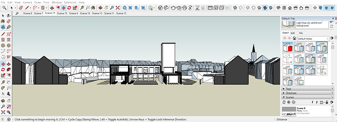

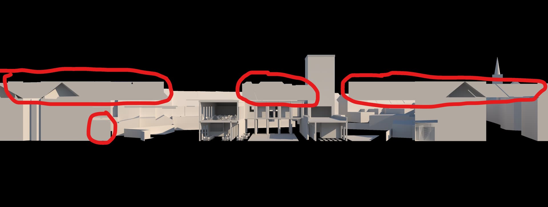

Hi I’m a new sketchup user, I’ve been trying to render my model on sketchup for a while but it keeps adding weird surfaces on the image and I can’t figure out what it is. This is from a section but nothing behind the section reflects those big patches so can anyone help??

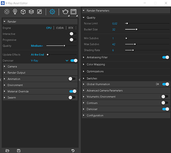

I’m using Vray, ill add more pictures. I don’t know if it helps, the .skp file is too big to put here it says.

Your model has a lot of reversed faces. There should be no exposed blue back faces.
What “big patches” are you referring to?
thank you, this part isn’t supposed to be on my render.
Is it possible to reverse the blue faces at once? Or do I do this manually
It depends on how you’ve built the model. You’ll probably need to select all of those blue back faces, right click on one of them and choose Reverse Faces.
It’s important to keep on top of correct face orientation as you go through the modeling process.

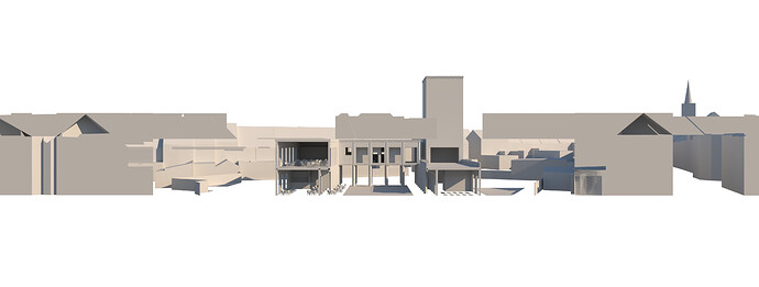

Yess, thank you very much. Took me long but the faces were the problem. Now the patches are gone
